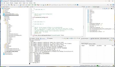

When U-boot is going to startup at the entry point address = 0x84000000, then this happens.IAC ID 137 is RISAF4 - DDR-SDRAM.SERC ID 32 is USART2.I don't know why USART2 seems to write at the Optee address region (0x82000000 - 0x83FFFFFF) and it all l...
