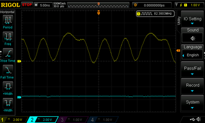

So extra for you:   :)
simple hi-lo-hi-lo loop , 250MHz core, optim -O2 , (all setting in IDE "normal", just at max speed) :
  /* USER CODE BEGIN WHILE */
  while (1)
	  GPIOG->BSRR = GPIO_PIN_4<<16;
	  GPIOG->BSRR = GPIO_PIN_4;
    /* USER CODE END WHILE */
    /* USER CODE BEGIN 3 */
you see : 4ns pin access, 16ns with while-loop : (bad picture, with a cheap 60MHz-probe)
82MHz - not bad , i would say...
