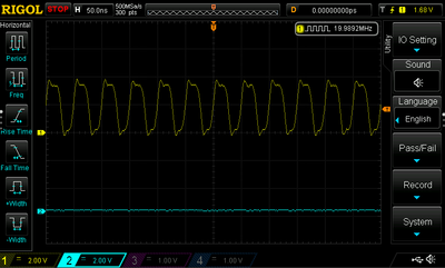

+ same on H743 , at 480MHz , -O2, ...same code in main:
20 MHz . :slightly_frowning_face:
But you can see effect of cache+core much faster than the bus to the port: no delay from while loop !
