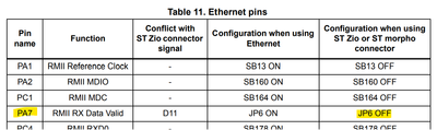

Hello, I would like to ask you to know how it is that the PA5 pin in OUTPUT (non-pullup and non-pulldown) delivers a voltage of only 2.6 V instead of 3.3 V like the others?
Thanks in advance
Per the schematic and the user manual, PA7 is used by the ethernet. If you want to use it through the header pins, you can isolate it from the ethernet by removing the JP6 jumper.

PA7 sorry
I tested on 3 st32f767zi, same problem
Please provide your schematics if you are using a custom board or tell us on which ST board you're doing the test.
Also provide your code.
I use a STM32F767ZI (Nucleo)
You can see thanks to the link my code :
https://github.com/TESSON-MAKER/Test_Pin_PA7/
