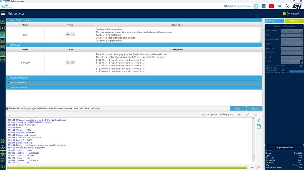

I checked and there is currently no enabled protection on the chip.
I can read and write the chip memory with the STM32CubeProgrammer and I even erased the chip but still the same problem.

Is this a custom board? Does your board go into low power states? If you do a full erase in STM32CubeProgrammer, does the next try at programming in STM32CubeIDE produce different results?
> ST-LINK detects target voltage = 1.71 V

‎2024-08-06 4:55 AM
Yes it is a custom board and the flashing was working perfectly until recently. I'm the only one facing this issue.
The board is working at 1.8V so the 1.71 is expected for us.
‎2024-08-06 5:42 AM
Now it says 1.70 V. Big difference between that and 1.8 V, given that the reset threshold is around 1.7 V. Any way to increase that to see if problems go away?
