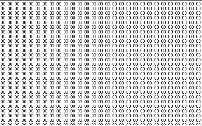

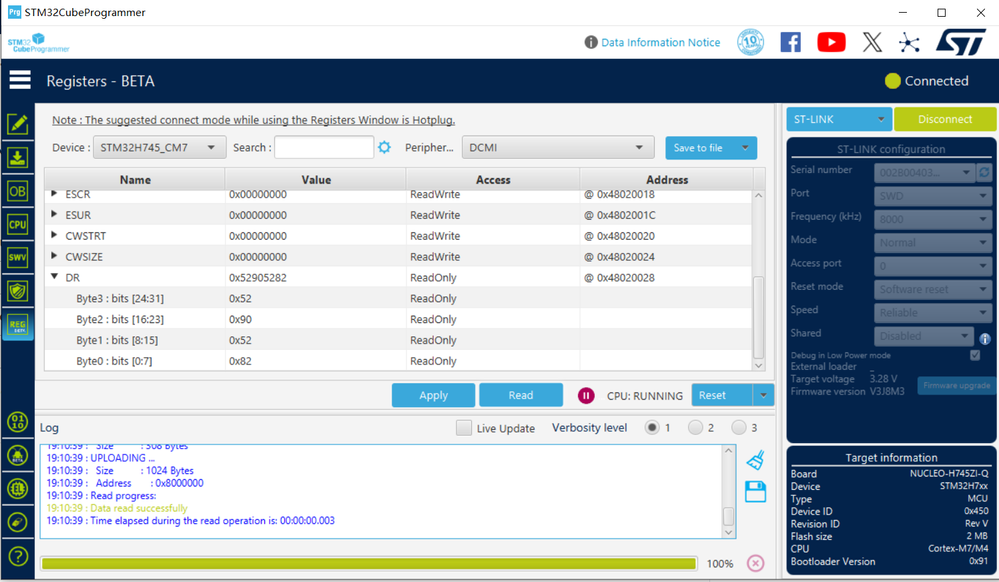

I tried to use this board to capture image by using DCMI DMA with a ov2640 camera. The problem is data read is successful in DCMI(by watching the register) but the buffer(initialized:uint32_t buffer[16000]={0}) used to store the image data was the same as it was initialized. I think this is a DMA problem.Register after running"HAL_DCMI_Start_DMA"Register after running"HAL_DCMI_Start_DMA"buffer(HEX) sent via USART after "HAL_DCMI_Stop"buffer(HEX) sent via USART after "HAL_DCMI_Stop"

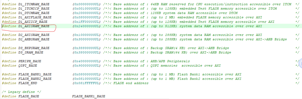

uint32_t dcmi_data_buff[16000];

		dcmi_dma_status = HAL_DCMI_Init(&hdcmi);
		printf("2\n");
		getStatus();
		for (uint8_t i=0; i<10;i++)
//	 		     HAL_DCMI_DisableCrop (&hdcmi);
	 	    	 DCMI_RN = 48;
	 	    	 DCMI_CN = 1280;
	 	    	 DCMI_RS = 48*i;
	 	    	 DCMI_CS = 0;
//	 	    	 HAL_DCMI_ConfigCrop (&hdcmi, DCMI_CS, DCMI_RS, DCMI_CN, DCMI_RN);
//	 	    	 HAL_Delay(1);
//	 	    	 HAL_DCMI_EnableCrop (&hdcmi);
//	 	    	 HAL_Delay(1);
						printf("3\n");
						getStatus();
						HAL_DCMI_Stop(&hdcmi);
						printf("4\n");
						getStatus();
						MX_DCMI_Init();
						printf("5\n");
						getStatus();
						__HAL_DCMI_ENABLE_IT(&hdcmi, DCMI_IT_FRAME);
	 	    	 dcmi_dma_status = HAL_DCMI_Start_DMA(&hdcmi, DCMI_MODE_CONTINUOUS, (uint32_t)&dcmi_data_buff, DCMI_CN*DCMI_RN/4);
						printf("6\n");
						getStatus();
	 	    	 while(HAL_DMA_GetState(&hdma_dcmi)==HAL_DMA_STATE_BUSY) ;
					 //HAL_DCMI_Resume(&hdcmi);
 	    	     tx_busy = 1;
		    	 Send((uint8_t *)dcmi_data_buff, 61440);
					HAL_Delay(1000000);
		    	 while(tx_busy!=0) ;

Ensure that dcmi_data_buff is not in DTCM and is somewhere the DMA can access.
While debugging the program, after the transfer should have taken plane, look at the DMA registers to see if an error occurred.
Data cache coherency might also be an issue in the future, although it's not the main culprit here. I suggest disabling it during the debugging stage.
Thank you for your solution, this problem has been solved but not still correctly get the image. But over all thank you!
Unfortunately I found it does not really work.I use "uint32_t dcmi_data_buff[2560] __attribute__((section(".ARM.__at_0x24040000")));" to give buffer a location DMA can reach.
but the content of buffer after HAL_DCMI_Start _DMA is the same as it was before HAL_DCMI_Start_DMA.I think the data I get is the original data in this location. Am I Wrong?
main.c:
