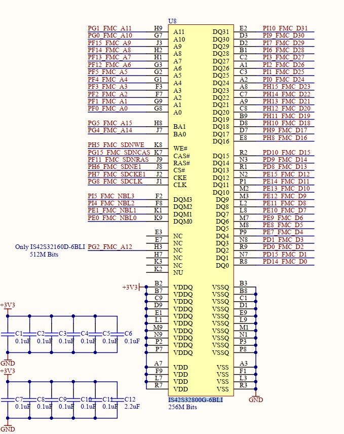

Hello Everyone ;
we are new to STM32H7  ; we used before stm32f4 in many projects but STM32H7 we still new; so I am sorry to ask simple questions.
We have designed our board based on STM32H743BI and SDRAM IS42R32160F-7. After a couple of weeks of trying to access the Sdarm, we could not make it work; sometimes we could read and write a few bytes ; sometimes up to 1k bytes but not more, and always crashes. It could be a clock setting problem or timing problem; or a connection problem between the MCU and SDRAM.
The MCU crystal is 12MHZ our goal is to run the MCU at 480MHZ and SDRAM at 100 MHZ
Let's start step by step please ;
my first question is to verify the pins connection please and SDRAM BANK; we assume that is should be bank 1  and mapped at  0X70000000 address.
could you confirm it please?

is the pins connection right ?
Thank you in advanced

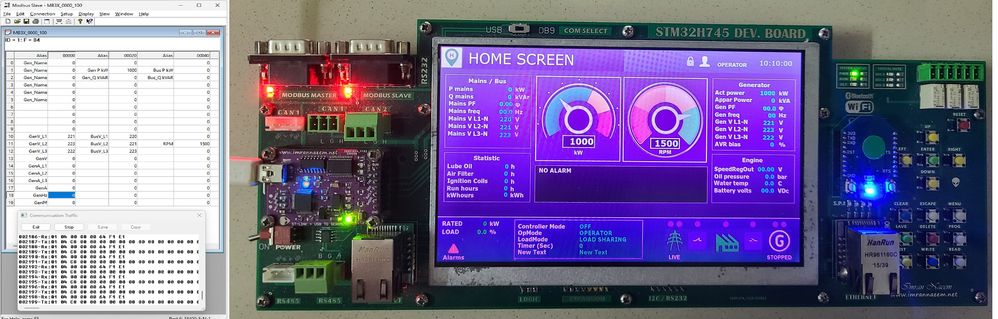

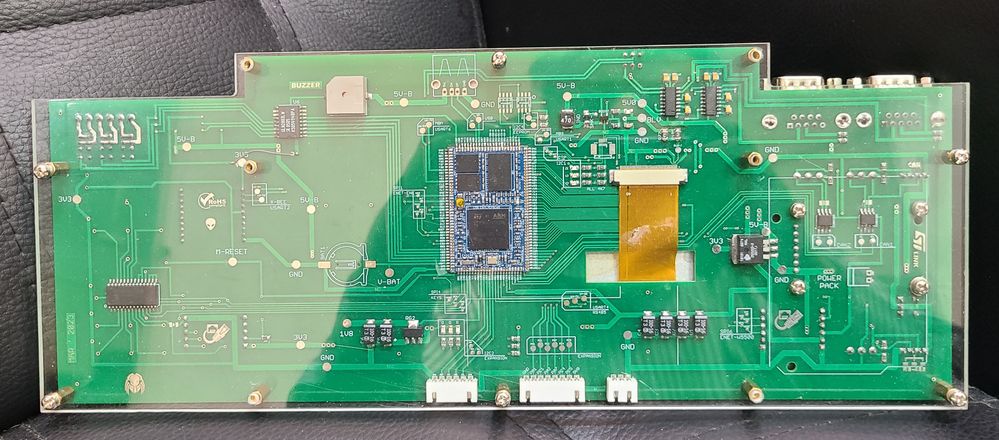

I am using 256MB SDRAM with STM32H745XIT6 (DUAL CORE) with TouchGFX at BANK 2 without any problem.
here is my custom designed board with STM32H745XIT6 & 1024X600 TFT.
CM4 running Modbus Master RTU
CM7 running TouchGFX with 256MB SDRAM

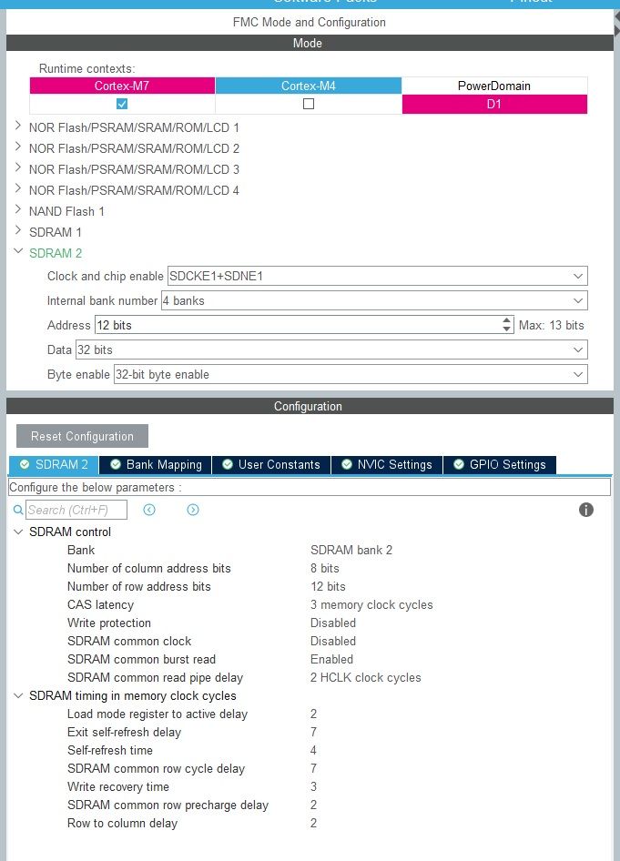

Here is the configuration in MX
Please check the timings of interface .
Imran

Hello Hector ...
In quick view , your interface looks fine .

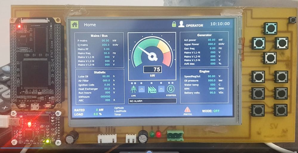

Here is TouchGFX , running on SAMSUNG TAB3 7.0 ,, 1024x600 , LVDS LCD & TouchGFX (STM32F429i-DISCOVERY + SN75LVDS83B) :
Here is TouchGFX , running on CHINESE 800X480 TFT (DE Mode) & TouchGFX (STM32F767 WILDFIRE BOARD)
Tested Modbus on it with same usb cable coz I developed st-link board with usb hub chip and ft232rl. (Power + SWD + USB232/modbus)
