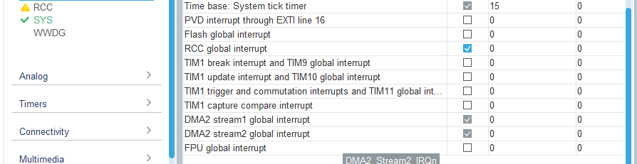

I doubt as follows
HAL_TIM_PWM_Start_DMA(&htim1, TIM_CHANNEL_1, (uint32_t *)sin_table, 20);//low
HAL_TIMEx_PWMN_Start_IT(&htim1, TIM_CHANNEL_1);
Here I am not used IT in the HAL_TIM_PWM_Start_DMA funtion , is it make any problem ?
anyway the cube ide enabled the DMA2 stream 1 and 2 as shown below .
