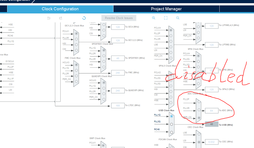

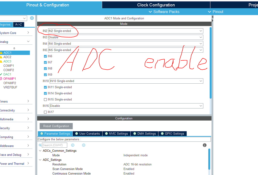

0693W00000Nqnq7QAB.png0693W00000Nqnq2QAB.pngMCU:STM32H743IIT6
STM32CubeMX:V6.5.0
"Pinout & Cofiguration" -->adc enable, but "Clock Configuration" ADC disabled.
Same project,STM32CubeMx6.4.0 is OK,but STM32CubeMx6.5.0 is wrong .so It is a Bug.
Hello @xsong.1​ ,
Yes you are right it is a bug, it is actually a known issue and it will be fixed soon. I will keep you posted.
The workaround for this issue is mentioned in my previous comment.
Sorry for the inconveniences,
Sara.
