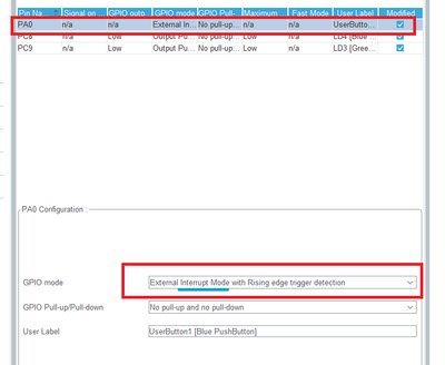

@johannv99 wrote:
also when set a breakpoint in. HAL_GPIO_EXTI_Callback() function.
This is because you set EXTI in event mode and not in interrupt mode and the NVIC configuration is missing. Fixed you ioc file in attachement.
You need to set interrupt mode:

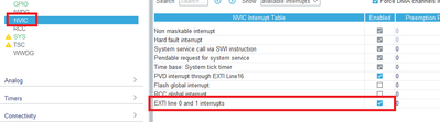

And in NVIC menu to enable  EXTI line 0:

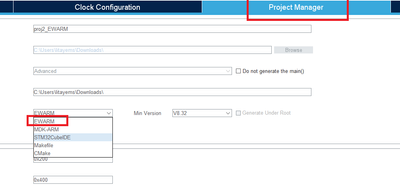

PS:
@johannv99 wrote:
Toolchain  / IDE EWARM
your example has : STM32CubeIDE
You can regenerate the code I've attached previously to generate EWARM project:
Hope it helps.
waclawek.jan
> void EXTI0_IRQHandler(void)
Note, that in STM32F0xx there is no dedicated EXTI0 interrupt. See Interrupts and events chapter in RM0091. Note, that @mƎALLEm above used:
> void EXTI0_1_IRQHandler(void)

That's because you enabled the EXTI NVIC but you didn't declare the EXTI IRQ handler ..
Did you test the ioc I shared? Use the user button (blue button on the board) to trigger the EXTI interrupt on PA0.
