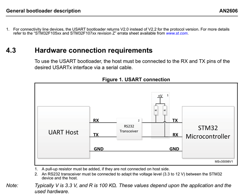

    Developing a firmware to update the application via Bootloader over USART2. But, the STM32U5G9BJYXQ is not responding on 0x7F. The MCU is successfully starts from the NSBOOTADD1(0x0bf90000) on driving the BOOT0 pin high while deasserting the reset. The USB-USART tool is sending a proper 0x7F, verified by oscilloscope. Please point to what I might be missing.

I have very few information to help You:
- Did You try to program you Board (custom?) with the STM32CubeProgrammer (using USART2)?
- Do You use the right Pin's for USART2 (PA2, PA3)?
- Are You able to use USART2 in your Application?

While continuing debugging, found some information which might explain the case more.
HSE = 25 MHz
Target system boot-loader interface: USART2, PA2, PA3
Ref.:
STM32 boot and startup tips - 2 Embedded bootloader investigations

And? Maybe try HSE 24 instead 25, but issue can be on many points. Check errata , check other Progversion etc.
Even parity?
If another interface is active, such as USB, it'll connect there and USART won't respond.
shubhenduatadben
Actually I got no luck and shifted to custom bootloader instead.
