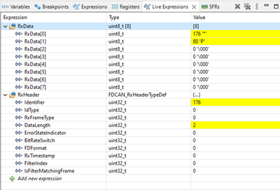

Hello @omkarprayag ,
As promised, I've created a project running on two NUCLEO-G474RE boards (same project in the attachment). I used your ioc file as a base to create the project with some little modifications. I'm using MCP2562FD as a transceiver from both sides PA11 and PA12 pins for CAN communication and it's working fine.
This is the live expression where I put the Rx data. As you can see the yellow color says that the Rx values are changing in live:
So, I'm pretty sure you have an issue with your HW.
Hope it helps.
