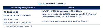

I am trying to configure the LPUART on my board, but appear to be getting nowhere. I've already configured the PLL to run at 110 MHz, and I changed the appropriate registers (`SW`) to use PLL as the system clock.
I've tried flashing the board with Zephyr OS just to make sure that it works, and it indeed works. When I use GDB to inspect the relevant registers (the ones changed by my code below) they appear to all have the values that I expect. I can't for the life of me figure out what is going on.
Using a logic analyzer, I see 0 activity on the TX pin, which is in a constant state of high.
Here is my code for configuring my LPUART (I am using CMSIS). I want a baud rate of 115200, and my board is configured to run at 110 MHz.

2025-06-28 8:17 AM
Code mostly looks to be usable, when you bring up the clocks/PLL, do you enable VDDIO2 ?
/* Enable VddIO2 for GPIOG */
HAL_PWREx_EnableVddIO2();

2025-07-02 1:06 PM
I did not, you are correct. The only addition I had to make was to add two lines to the code. Thank you so much for your suggestion; I would _never_ have thought of checking that on my own.
Here is the completed LPUART configuration code, for reference
