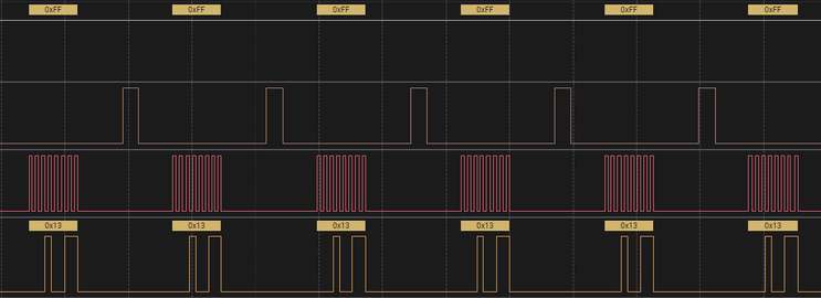

I am trying to set up a SPI communication to the STM32WL's integrated LoRa transceiver. So, I was able get NSS, MOSI and SCK to work, however I won't receive any data on the MISO line.
My code is following:

I call this code in main.c by executing this:
while(1) {
		PWR->SUBGHZSPICR &= ~(1 << 15); // NSS low
		while (!(SUBGHZSPI->SR & (1 << 1))); // TXE
		*(__IO uint8_t*)(&SUBGHZSPI->DR) = 0x13;
		while (!(SUBGHZSPI->SR & (1 << 0))); // RXNE
		uint32_t status = SUBGHZSPI->DR;
		PWR->SUBGHZSPICR |= (1 << 15); // NSS high
I can transmit data and can also verify with my logic level analyzer but the MISO line always stays high:
Can anyone help me getting this running? Am I missing anythin?
Thanks in advance
3 REPLIES 3
MISO is driven by the slave, not the master. What is it connected to?
It is connected to the internal LoRa-Transceiver (Semtech SX126x). I configured the physical pins only for debugging purposes. I know that the MISO is driven by the Slave, I just can't influence the physical wiring since the SPI is internally wired.
