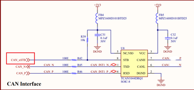

1- How about the two terminating resistors on both sides of the bus 120ohm each? I don't see it in the shared schematics.
2- What about CAN_nSTB status?:
3- As I understood from your sketch the two nodes are composed of STM32G474, am I right?
4- Again please share your simple code you used for the test to prevent many useless ping pongs.
Thank you.

Ans :  1- The shared schematic is for a single node. I am connecting two identical nodes in parallel, and both have 120Ω termination resistors. I also tested the configuration by removing the termination resistor from one of the nodes on the bus, but the issue persists.
Ans : 2-  The CAN_nSTB pin is not being used. It is set to logic HIGH due to the pull-up resistor.
Ans : 3- This schematic represents only one node. When I connect two such nodes to the bus, I encounter a passive bus error with this configuration.
Ans : 4- Please find the attached code for a simple project.
No. Please review what I shared previously from the transceiver datasheet:
-> In normal operation this pin needs to be at GND level otherwise (connected to VDD or over internal pull-up) the transceiver will be in standby mode -> no communication.
@mƎALLEm ,
Thank you for your response.
In the code, the pin is already configured to logic '0'. I have also physically connected it to GND, but the issue persists.
