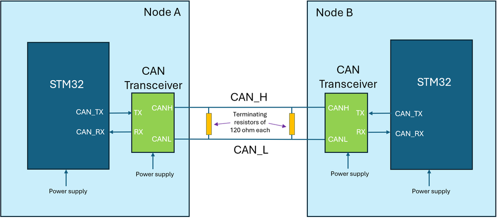

Could you confirm again you have this structure for this test?:
Meanwhile, you need to check again your HW:
1- Check the transceiver power supply: check directly the power on the chip pins: VCC (5V) on pin3 and VIO (3.3V) on pin 5.
2- Check again your wiring between the transceivers: CAN_H to CAN_H pin 7 of both transceivers / CAN_L to CAN_L pin 6 of both transceivers. Use continuity option of the multimeter. For this you need to power off the board before the check.

@SofLit ,
Yes, the connections you mentioned are the same on my end. I have verified them multiple times.
Answer 1: Yes, the power supply is as expected VCC (5V) on pin3 and VIO (3.3V) on pin 5.
Answer 2: Yes, the wiring, termination resistors and connection are intact.
P.S.: When I connect a CAN analyzer to the bus, communication works correctly without any issues. This confirms that both the communication and physical connections are functioning properly
