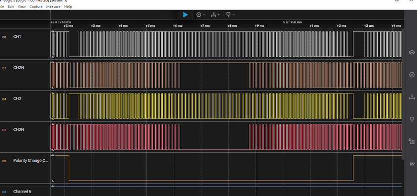

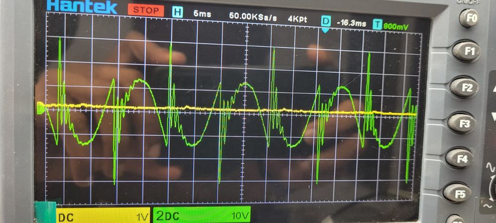

But I tried Likewise , but whenever the polarity changes its makes high spikes plese look the image
As am a beginer am dont know the exact problem
I used one Half cycle , CH1 output polarity is normal , and CH2 's polarty is inverted , whenever thehalf array value is transfered by the DMA the PWM_PulseFinishedCallback funtion trigger aand it inverter  the polarty of the channels . aand working as expected see the above logic signals .
