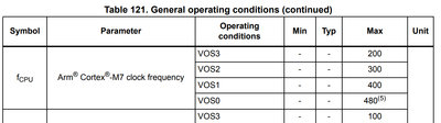

This is also given in the datasheet:
You can ask: but these are Max frequencies so I can set VOS1 and keep the system frequency to 200MHz it works but this has two drawbacks:
- Increase the power consumption.
- Accelerate the product aging.
That's why you need to follow the table.
In the Table 121, it says the VOS3 mode has a maximum 200mhz.
but before this you said to change the system clock at 400MHz, which is the maximum of VOS1 mode.
So.... does this mean that i have to change into VOS1 mode to use 400mhz?
Instead of setting system clock in 400mhz while using VOS3 mode?
I'm quite confused...
In order to get 80 MHz CAN clock, you need to be in VOS1 per the table shown.
Any clock setting in VOS1 will work, provided that you can configure the CAN clock to 80 MHz with PLL settings.. It does not need to be 400 MHz, you can keep it at 200 MHz.
You cannot set a system clock of 400 MHz in VOS3. It is limited to 200 MHz, as shown in the table.
Read the tables, all the info is there.

There is no confusion here.
Sys freq =< 200MHz -> VOS3
200MHz < Sys freq =< 300MHz -> VOS2
300MHz < Sys freq =< 400MHz -> VOS1
400MHz < Sys freq =< 480MHz -> VOS0
As I said, you need to respect these ranges in selecting the voltage scale for the reasons I mentioned before.
