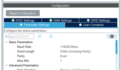

Hi all,i am using STM32C011F4U6 and i want communication between Uart1 _baud rate -115200 _8N1 and Uart2_Baud rate _4800_7E1.But STM32C0 haven't 7 bit communication option. How can i do this?

Then: what makes you think that the C011 cannot be set to 7bit?
As @Tesla DeLorean explained in the other thread, you have to programme a word length of 8 bits for 7N1. The RM0490 also mentions under USART main features: Programmable data word length (7, 8 or 9 bits).

‎2024-08-29 6:06 AM
CubeMX settings for 7E1 are as follows:
Note that "word length" includes the parity bit.

‎2024-08-29 8:21 AM
Rest-of-World
8E1
ST
UartHandle.Init.WordLength = UART_WORDLENGTH_9B; // 8+Parity
UartHandle.Init.StopBits = UART_STOPBITS_1;
UartHandle.Init.Parity = UART_PARITY_EVEN;
Rest-of-World
7E1
ST
UartHandle.Init.WordLength = UART_WORDLENGTH_8B; // 7+Parity
‎2024-08-30 2:14 AM - edited ‎2024-08-30 2:14 AM
Thanks for your support ,problem solved.I did as above setting @Tesla DeLorean .
