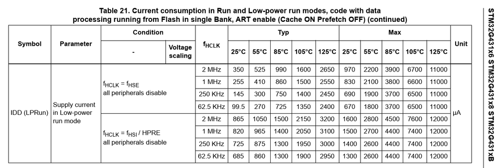

I've been working on reducing the power consumption of a project I'm working on using the STM32G431.
Stop modes are not an option on this chip since I need to keep some peripherals active, but I've been
able to reduce the needed system clock to below 1Mhz, and use the LP-Run/Sleep modes exclusively.
I've gone as far as I can in terms of reducing overall frequency. According to the CubeMx power estimator pane, I can  reduce the power consumption further by about 75% by avoiding the use of a crystal and supplying an external clock
signal instead. This so-called "HSE Bypass" mode powers down the oscillator circuit as well as the PLL.
But I've run into a wall in implementing this. If I can't use a crystal, what do I put on the board to generate my (say, 1Mhz) clock? I don't have an FPGA or a big-brother CPU on the board to provide the clock. And to add one would negate the power savings several times over (to say nothing of the BOM cost).
I've searched for dedicated clock generators, but what I've found so far seems to aim at much higher frequencies and still requires 10x the power used by the G431 to run.
Are there any jellybean chips/solutions for this? basically, I need an IC that generates a (say) 1Mhz clock while consuming only 10-100uA.

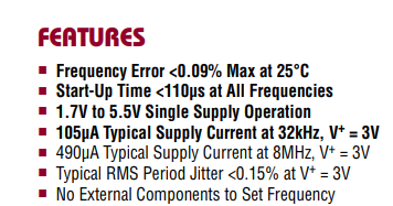

Funnily enough, after chasing down all kinds of 90s relics the only viable solution I've come up with is to use a modern variant of the 555. The LMC555 from TI is programmable up to 3Mhz and draws somewhere between 130-250uA. That should work. Of course, it relies on an RC circuit for timing so with "civilian" component tolerances that would mean about a 2% variation in frequency at least. I could probably live with that, but it's not ideal.
Even more strange is the fact that there *used* to be such an IC. The Harris HA7210 (1996) (Harris->Intersil->Renesas). According to the datasheet, it used a crystal oscillator as an input but only consumed 100uA at 1Mhz. It's an EOL part and I've found no replacements with Active Status so far.

> According to the power estimator, HSI16 does not provide anywhere near the same power reduction as HSE bypass.
HSE with 8MHz crystal consumes around 500uA typ, according to the DS, while HSI16 around 155uA typ 190uA max. You want to divide the AHB accordingly to run the rest of the mcu at the same frequency (say 2MHz), in order to get them into the same consumption level.
HSE bypass does not consume anything, but the external oscillator does, and it will be in the 150uA ballpark.
You can try all these options first-hand using a cheap Nucleo board.
That's static consumption. I am curious how much would operating it at 1-2MHz add to this, and how much would be the current spent in the external RC circuitry.
Interesting, but, as you've said, gone.
With enough design effort, you may be able to design a low-power crystal oscillator from discretes.
There's also interesting but generally unusable (expensive, non-crystal-precision) LTC6906.
