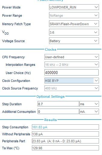

The reason I'm so set on HSE bypass and using an external clock, is that the power estimator claims dramatic power reduction (even including the 100-200uA an external clock would/should/hopefully might consume).

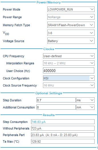

In particular, the power estimator says that HSI16 (or indirectly via the circuitry involved in employing it) would consumes roughly 600uA in my design, and not 150uA as you suggest (based on the DS). See shots below. It's possible the estimator is simply wrong for this corner case. Are you saying I should disregard it as a a bug? It possible the oscillator circuitry's power consumption scales with the frequency of the source. Since the HSI16 input is 16Mhz, even if I divide it later, I still pay the cost at the clock input. I could be wrong.
I don't know where did it get that figure from.

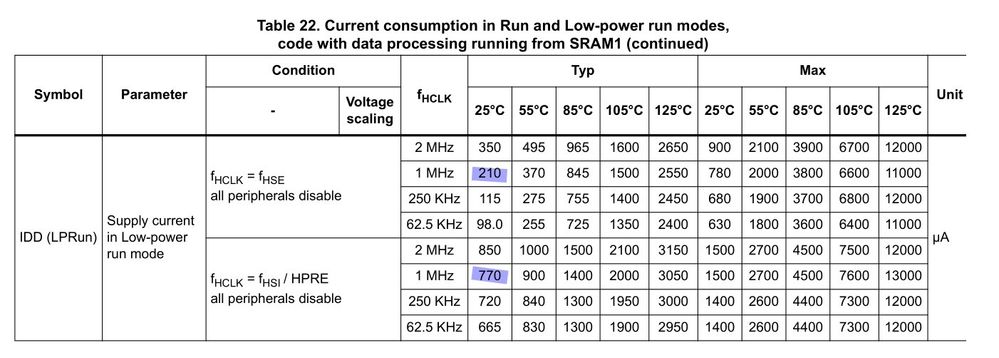

The authorative answer is the datasheet. The power estimator is some implementation based on the datasheet, but may be wrong implemented. For HSI16 , max current is 190 uA in the datasheet. Clock down HSI16 with the AHB prescaler and this is probably the best you can do with STM32G4. Resonsider a low power family is you need even lower current, lik U0 or U5.

I thought the power estimator must be backed up by numbers in the datasheet, and so I checked:G4_LP_IDD.jpg
As you can see, power consumption is much lower for HSE Bypass than when using the internal HSI16.
Furthermore, although I can't find an explicit statement to this effect in the datasheet,  for LP-run/Sleep modes the power estimator only accepts HSI or HSE Bypass(i.e. external clock) as sources. That suggests to me that using an external crystal in those modes is not even possible. It's divided HSI or external clock only. I could be wrong. (Update: Indeed I was wrong. ST rep confirms HSE crystal can be used in Low power mode. But the circuits supporting an external crystal itself consume appreciable power)
