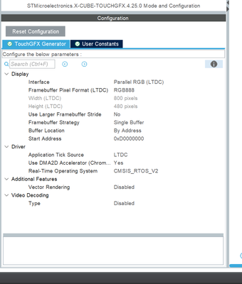

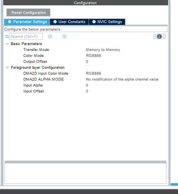

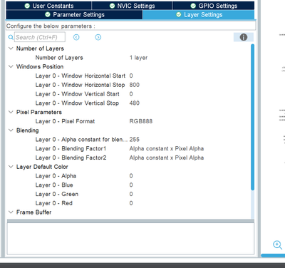

I am currently trying to use touchGFX to design my GUI in a custom board. Before trying to use touchGFX, I set up the LTDC and FMC to use an external SDRAM to hold the buffer and it works fine (I can draw on the screen). However, I've been struggling to setup the touchGFX and being able to only get some random pixels. I noticed from the templates that an external flash is being used to hold initial assets generated at touchGFX, but my board does not have an external flash right now.
Is it possible to run touchGFX from internal flash, and use only external sdram for the framebuffer?
I'll share the configurations I have so far:
And here is my ld file:
I'd imagine if the content fit. Your linker script doesn't describe any external NOR Flash, so wouldn't use it. Does it build now, or run out of space?

I - I thought that if the content would not fit, it would appear in the terminal during the flashing, is it incorrect?
II - This is the ld file generated by the IDE. I've never coded in the ld file before, so I was a little afraid of trying to change things in that file, because I already erased the vector table once trying things like this and wasn't able to boot the MCU again. So, is there a RM that I could read to learn how to deal with it?
III - The code builds it, I can even flash the code onto the MCU, however I never see changes in the screen other than some random static pixels.
Note: I even used a fill.rect function within the touchGFX file, and confirmed that it changed the data in the SDRAM, but for some reason it does not send the data generated for the GUI (just a picture) created in the touchGFX. I tried to read the documentation, but I mostly found instructions of how to set it up in the development boards and nothing about how to make it work in a custom board. Is there a document you recommend so I can learn?
