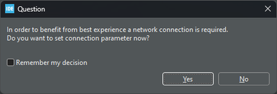

Could you try to do the following steps:
  1. Set Target Selector Device Database Auto-Refresh to "No Auto refresh" under Window > Preferences > STM32Cube > Firmware Update
  2. Close STM32CubeIDE
  3. Deleted the .stmcufinder folder from my user directory:
    C:\Users\<MyUsername>\.stmcufinder
  4. Open STM32CubeIDE and when he following pop up message appears click on "NO"
This will continue to be the temporary solution. Our teams have identified the root cause and a permanent fix will be shared shortly.
KR,
Semer.

I don't get any pop-ups like the one mentioned in the image even after following steps 1-3.
