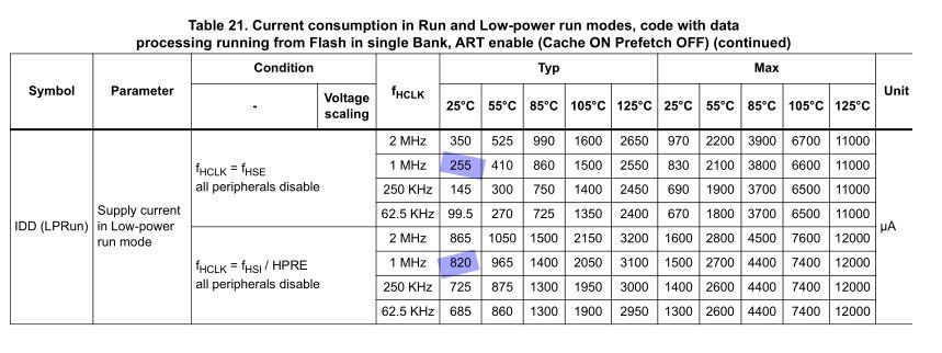

Since there is no obvious to ping an ST rep directly from an ongoing thread, I'm posting these questions in a new thread in the hope that ST will respond with answers.
These arose during discussion in another thread:
How Can I Provide a 1mhz HSE Bypass Clock For Low-Power - Without Wasting More Power Than I Save??
Questions:
1. In "Low-Power RUN" mode, the current consumption at 1Mhz given by datasheet (refA)
is 255uA for fHSE, and 820 uA for fHSI. The power consumption with HSI is noticeably higher.
What is the reason for this difference in power consumption?
2. Does "Low-Power RUN" mode support the use of an HSE *crystal*, or only HSE Bypass mode (i.e. an external clock).
(The following questions assume an HSE crystal is supported in "Low-Power RUN" mode):
3. Do the datasheet tables for "Low-Power RUN" (see refA), which detail the current consumption
for "HSE" assume the use of HSE bypass (i.e. external clock), or are they valid when an
external crystal is used?
4. If use of an HSE crystal is possible in "Low-Power RUN" mode, what is the current
consumption in that configuration?
(refAa) DS12589 Rev 6, "STM32G431 Datasheet", Table 21 "Current Consumption In Low-Power run modes (continued)", pp 77/196.

Simon.T
June 13, 2024
Hello @BarryWhit ,
First of all, if you want to have a dedicated support with ST employee you can create an OLS ticket through this link.
When I'm giving a table number, I took the DS12589 Rev 6 as reference.
 1. What is the reason for this difference in power consumption?
The consumption is higher due to the HSI consumption itself (see Table 42) and also all the clock divider linked to this clock.
Sure the Low-Power RUN support both HSE configuration.
All the datasheet power consumption data using the HSE as clock source are in bypass mode.
consumption in that
configuration?
It mostly depends of your crystal oscillator parameters, in the Table 40 of the datasheet you can have an idea about the crystal power consumption that you need to add.
Best regards,
Simon

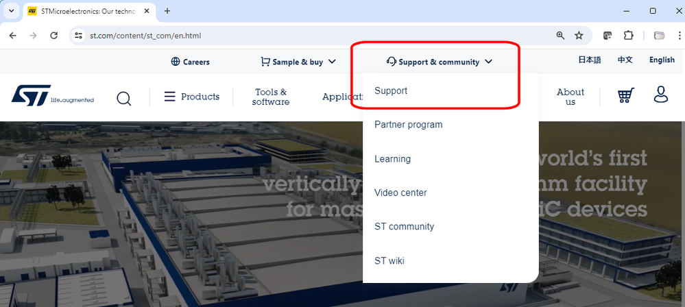

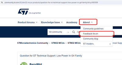

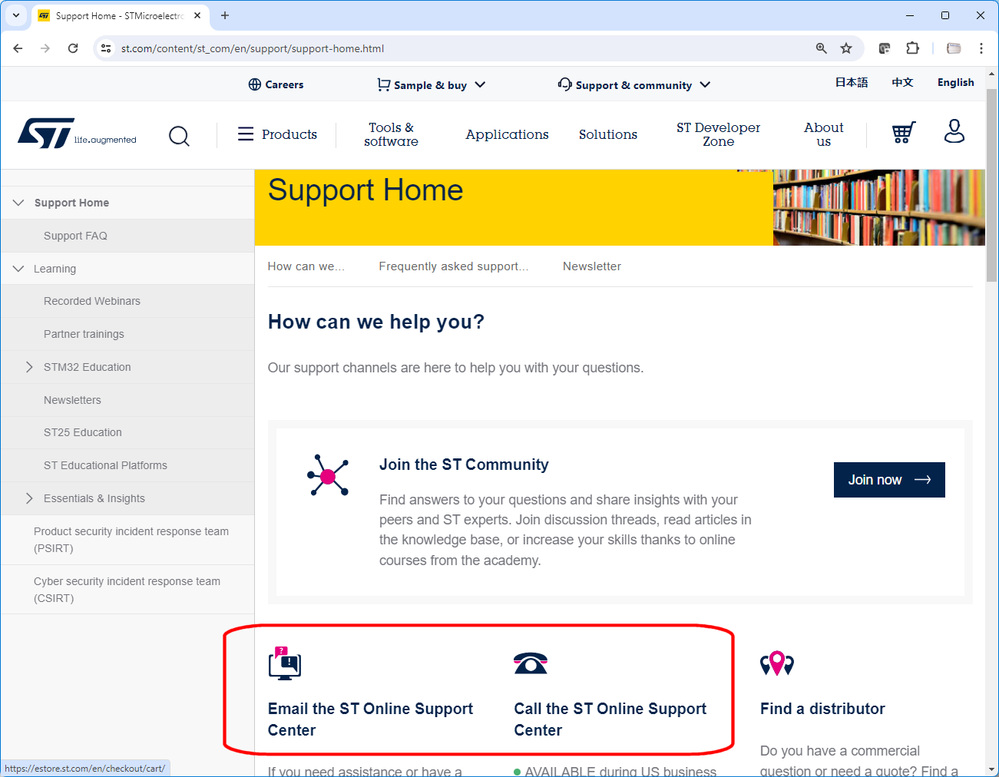

Andrew Neil
June 13, 2024
You can '@' mention them?
This is the public forum; if you want private support, use the support link from the ST homepage:
Note that you can give feedback to ST about the forum & its operation:
waclawek.jan
June 13, 2024
Hi @Simon.T ,
The HSI consumption according to Tab.42 is 155uA typ 190uA max, whereas the difference we are talking about is almost 500uA.
Do you say, that using HSI always implies consumption increase of cca 500uA (due to "all the clock divider linked to this clock")? What's the point of giving 155uA as typ. HSI consumption, then? I'd call this misleading.
