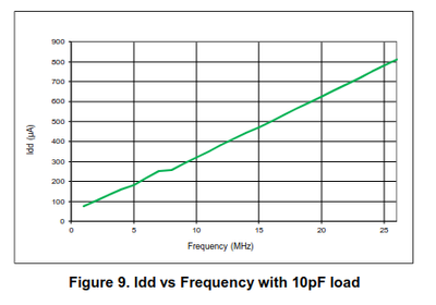

Yes, I now see that digikey also carries the SiT1579 MEMS Oscillator and its siblings, as Andrew.Neil suggested earlier.
- If someone's post helped resolve your issue, please thank them by clicking "Accept as Solution".
- Please post an update with details once you've solved your issue. Your experience may help others.
If you can handle the case ... :)
maybe SIT8021AI-J4-XXS-1.162000  (digikey) might get you some uA less, about 100uA at 1,1MHz :
But its case : 1.5 mm x 0.8 mm , 0,41 mm pitch - only for reflow + pick'n place.
