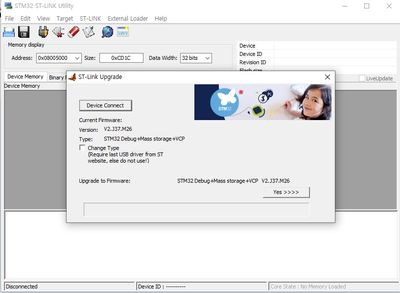

I found the motor value using the Motor Profiler 5.4.8 program (P-NUCLEO-IHM002).
(Figure1)
The Motor Pilot_6.3.0 program does not connect using UART.(Discover Board / Launch Profiler)
(Figure3)
Even if I change the UART Speed, the "Port Open and try to configure the board" error only appears.
(Figure4)

After purchasing EVSPIN32G4, I only updated ST-LINK after connecting Micro USB.

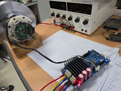

It is connected to the motor as shown below.
The board cannot be connected in ST Motor Pilot.
How do I connect?
kelvin.wang
MCSDK 6.3 Profile need user to add FW manually by create new project ,you may refer to MCSDK document in "about" ICON and search "Motor Profiler Application Note"
