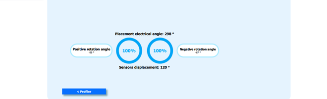

I am currently working with the STM32 Motor Control SDK and would like to ask a question regarding the Placement Electrical Angle.
Due to hardware limitations (single-shunt current sensing) and tool constraints, I am unable to use the Motor Profiler.
In this situation, I would like to know:
  • Is it possible to measure or determine the Placement Electrical Angle without using the Motor Profiler?
  • If so, does ST recommend a manual or alternative procedure (for example, forced alignment using d-axis current, open-loop control, or hall-sensor-based methods)?
  • Are there any application notes, user manuals, or example projects that describe this procedure in detail?
For your reference, I am using a motor with Hall sensors and the STM32 Motor Control SDK.
Thank you in advance for your support.
Best regards,
Pelino

Yes, it is possible open the MCSDK documentation in that
You need to create a Neutral point from the 3 phases.
