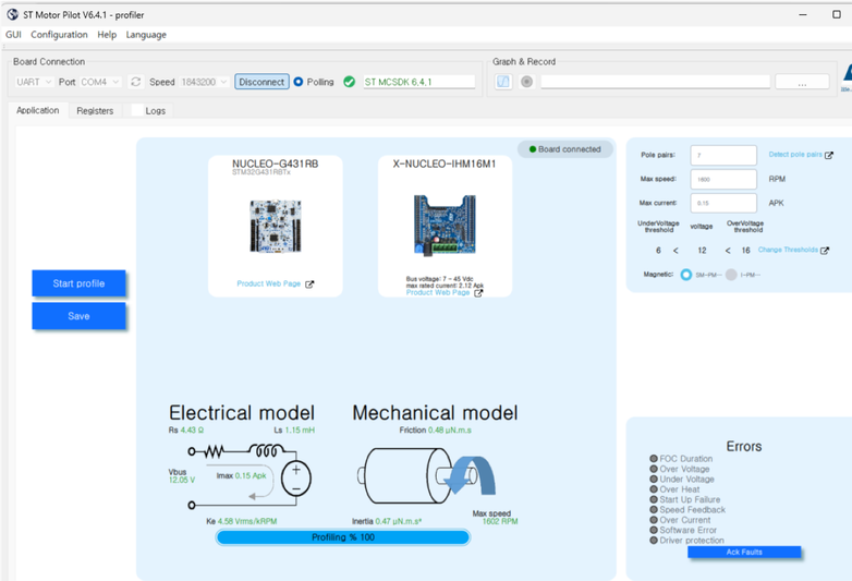

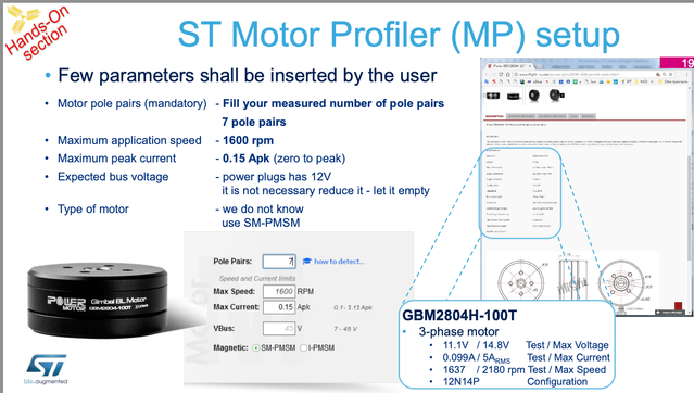

I configured the motor settings by referring to the motor setup guide document as described below and then performed the setup using the Motor Profiler.
After that, when I measured the parameters using the method you provided that does not rely on the Motor Profiler, I observed the following differences.
Motor Profiler results:
Rs: 4.43, Ke: 4.58
Measurements using a multimeter and an oscilloscope:
Rs: 4.65, Ke: 3.677
Could you please advise what level of deviation between these two measurement methods is considered acceptable?
I would appreciate your confirmation.
