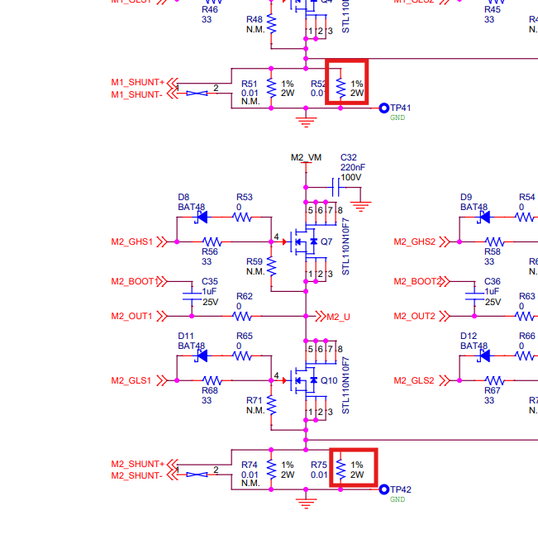

"C38 and C42 are not populated. Could this cause false overcurrent detection?"

Regarding the Overcurrent Protection,
if the current exceeds the maximum current value of 1.7 A, will the protection be triggered?
Also, was the current waveform shown below measured using a shunt resistor?
Is there a way to measure or monitor the current using Motor Pilot instead?

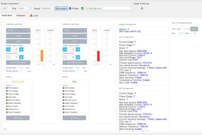

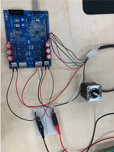

I created an EVSPIN32G4-DUAL project using MK Workbench.
I am currently testing with only one motor connected to the EVSPIN32G4-DUAL.
As shown below, an Overcurrent Fault occurs on Motor 1.
Even after changing the environment settings as shown below, the Overcurrent error still occurs.

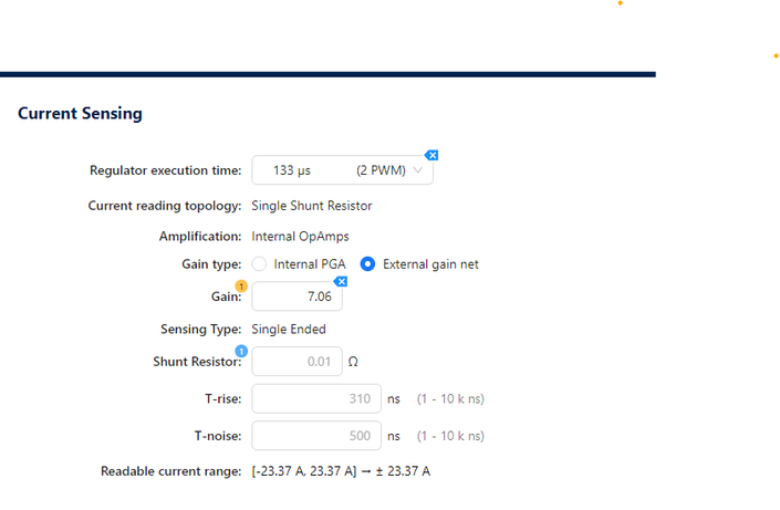

1. Check of the current sensing topology

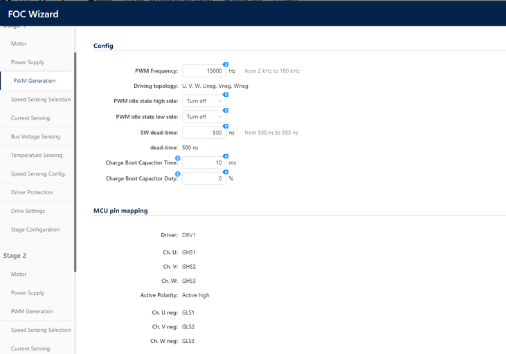

2. Change the PWM frequency

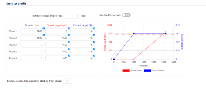

3. Change the start-up profile

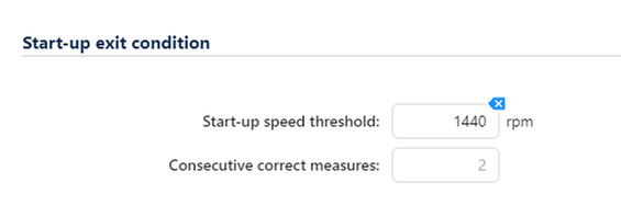

4.Modify the sensorless start-up parameters

Hello @pelino,
By default, Overcurrent protection and Driver protection use the same BKIN input. Using Overcurrent protection on BKIN2, if Driver protection is triggered instead of overcurrent protection, try using the default parameter settings and close the VDSMON DIS jumpers (open on your attached picture).
An issue might trigger driver protection at startup due to VDS monitoring. This issue will be resolved in the next release.
If you agree with the answer, please accept it by clicking on 'Best answer'.Best regards.GMA

Hello @GMA
As you mentioned, when I close J2, the system operates normally.
However, I still do not fully understand the behavior.

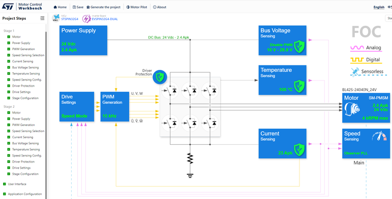

Even if BRK2 is designed mainly for Overcurrent Protection,
if BRK2 is also used by Driver Protection to evaluate voltages as shown below,
shouldn’t it be judged correctly under normal conditions?
If so, why does an error occur?
Is this potentially a hardware issue, or is it related to the protection configuration?
Also, when SCREF is disabled,
does this disable only the VDS monitoring protection, or are other protections affected as well?
COMP2 is used for Overcurrent Protection.
According to the block diagram below,
when either Overcurrent Protection or VDS Monitoring Protection is triggered,
the nFAULT output is asserted low.
However, the Control Logic block diagram above does not seem to match
the Break feature block diagram below.
In the lower diagram, the BRK signal is driven by the COMP1 result.
In the upper diagram, the Control Logic drives nFAULT instead.
Because of this, the two block diagrams do not appear to be consistent.
Does this mean that the block diagrams do not directly map to the actual behavior of the STSPIN32G4,
or am I misunderstanding how these protection paths are internally connected?
