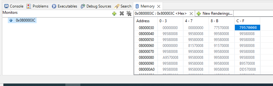

Open the memory view at 0x0800003C and check whether it contains the SysTick_Handler() address.

0693W00000QLSZtQAP.pngFrom the .map file.
 .text.SysTick_Handler
        0x0000000008005778    0x8 ./Core/Src/stm32g0xx_it.o
        0x0000000008005778        SysTick_Handler
Why is it off by 1? 0x08005779? Should be a number divisible by 4 I would think.
It looks like all the vectors are odd numbers.

Which looks right.
KnarfB
Principal III
LSB 1 indicates thumb mode, looks correct.
