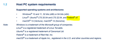

I have installed a fresh STM32CubeProgrammer on my Fedora 41 Linux system, but I am unable to run it.
After installation, I have tried running it both using the desktop menu entry and from terminal, however it never starts and crashes with the message "assertion 'GDK_IS_X11_DISPLAY (display)' failed"

Can you help me resolve the issue?
Best answer by STTwo-32
Hello @remes-mymi and welcome to the ST Community.
As mentionned on the release note of the last version of the STM32CubeProgrammer, the version supported of Fedora is the Fedora 37:
Best Regards.

November 4, 2024
Hello @STTwo-32, thank you for your answer.
Are there any plans regarding support for Fedora 41? Can I provide any assistance?
In the meantime, I will be using alternative solutions, since I cannot downgrade to Fedora 37.
STTwo-32
November 4, 2024
Fedora 41 is really new. It may come on one of the releases of 2025 (I can't give you an exact release or date).
