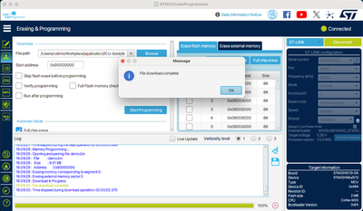

I'm trying to interact with the external flash on the STM32H573I-DK, and having some issues. I'm using the `MX25LM51245G_STM32H573I-DK-RevB.stldr` external loader.

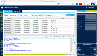

Using the J-Link, I can read the flash and erase sectors, but the program immediately crashes when I try to program a file. It works fine using the ST-LINK.
ST-LINK programming:
J-Link reading and erasing:

ST-LINK
./STM32_Programmer_CLI -c port=SWD mode=UR reset=HWrst freq=4000 ap=1 -el ExternalLoader/MX25LM51245G_STM32H573I-DK-RevB.stldr -d demo.bin 0x90000000
 STM32CubeProgrammer v2.17.0
ST-LINK SN : 0051002D3532511731333430
ST-LINK FW : V3J11M3
Board : STM32H573I-DK
Voltage : 3.29V
SWD freq : 3300 KHz
Connect mode: Under Reset
Reset mode : Hardware reset
Device ID : 0x484
Revision ID : --
Device name : STM32H56x/573
Flash size : 2 MBytes
Device type : MCU
Device CPU : Cortex-M33
BL Version : 0xE4
SFSP Version: v2.5.0
Debug in Low Power mode enabled
Memory Programming ...
Opening and parsing file: demo.bin
 File : demo.bin
 Address : 0x90000000
Erasing external memory sector 0
Download in Progress:
[==================================================] 100%
File download complete
Time elapsed during download operation: 00:00:00.430
J-Link
./STM32_Programmer_CLI -c port=JLINK mode=UR reset=HWrst freq=4000 ap=1 -el ExternalLoader/MX25LM51245G_STM32H573I-DK-RevB.stldr -d demo.bin 0x90000000
Connecting to J-Link Probe
Device=Cortex-M33
Device ID : 0x484
Voltage : 3.31V
Segmentation fault: 11

A segmentation fault suggests a software bug in STM32CubeProgrammer when handling J-Link with this specific setup.  STM32CubeProgrammer CLI installation may be corrupted. Try to run STM32CubeProgrammer with --verbose to get more detailed logs.
November 13, 2024
This happens with both the GUI and the CLI, but there's nothing to show/report with the GUI as it just crashes.
I have ran with the highest verbosity, but the output is not nearly as verbose as it is using the ST-LINK connection. I've included snippets for the failed download and for a succesfully erase of a couple of sectors of the external flash.

@colinmurphygc If you have a genuine J-link - while ST is working on a fix, you can program the flash with Segger J-Flash software. Segger developed "universal" loader for QSPI memories. User only has to select the pinout of the QSPI memory, then the loader automatically detects the model and size of the flash chip and does its magic.

The GUI does produce a log error file; if it is of use I can send the full copy. I've included what looks relevant:
# C [libCubeProgrammer_API.dylib+0x13780e] ST_LINKInterface::DisableWDGRST(TargetInterface*, ST_LINKInterface*, bool)+0x2e
Stack: [0x0000000308577000,0x0000000308677000], sp=0x0000000308675790, free space=1017k
 Native frames: (J=compiled Java code, j=interpreted, Vv=VM code, C=native code)
 C [libCubeProgrammer_API.dylib+0xe041] downloadFile+0x191
 C [jna9175919993682943405.tmp+0xdef4] ffi_call_unix64+0x4c
 C 0x00000003086763f8
January 23, 2025
I have tested this on v2.18.0 and it has been fixed.
