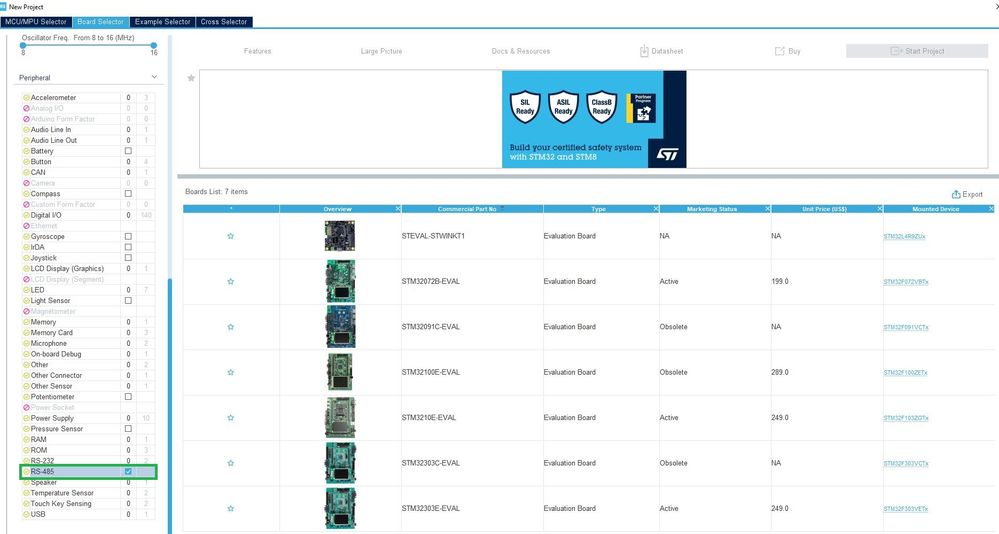

To display the list of ST boards supported RS485:
Launch STM32CubeMX, select File > New Project > Board Selector tab, then filter criteria (RS485) on Peripheral tree.
Hope this may bring you some help.
