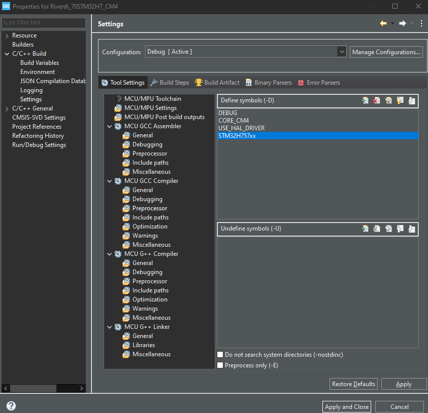

We had an old project where openamp worked perfectly with the same version (of openamp), what was diffrent was the custom configuration for a specific display(from TGFX 4.25.0) and the version of the ioc file. The actual user configuration in the ioc is the same as is the code.
Now we have to make a new project based on touchgfx Custom board configuration 70STM32H7 v4.1.0. The old one was based on 70STM32H7 v3.2.0 (STMCubeMX version: v6.10.0 and FW_H7 V1.11.1) and worked fine without such errors. Openamp versions match on both IOCs.
I checked the errno.h file for the definitions.
I am currently working on the M4 core. I setup openamp in the ioc then converted main.c to main.cpp. When I try building I get the following errors:
C:/Users/Uporabnik/Documents/Riverdi7NewConfig/Middlewares/Third_Party/OpenAMP/libmetal/lib/include/metal/system/generic/condition.h: In function 'metal_condition_signal':
C:/Users/Uporabnik/Documents/Riverdi7NewConfig/Middlewares/Third_Party/OpenAMP/libmetal/lib/include/metal/system/generic/condition.h:56:25: error: 'EINVAL' undeclared (first use in this function)

I would appreciate any help. I could not find any solutions online.
Jakicaa
The newer IOC version had the wrong symbol in preprocessor, the solution is to change the STM32H747xx to STM32H757xx in Project properties -> C/C++ Build -> Settings -> Tool Settings -> MCU GCC Compiler -> Preprocessor -> Double click on STM32H747xx and change it to STM32H757xx.
I think this issue is only related to creating a project for the riverdi 7 from touchgfx inch display using the riverdi custom configuration 70STM32H7 v4.1 and probably all versions above v3.0. Riverdi knows of this.

It seems there is an underlying problem. After creating a new project and not touching the ioc just trying to build the M4 core I get this error:

 Probably have to sort this out first.
Jakicaa
