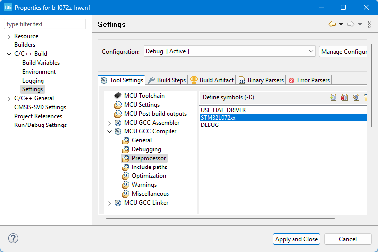

The used chip part number gets defined in the Project defines:
you could use that?

@Andrew Neil wrote:The used chip part number gets defined in the Project defines:
you could use that?
I could but that would mean specifying every chip part number within the preprocessor check. I want to avoid that as much as possible such as in a situation where the entire family of chips is affected versus just a couple within a family.
I suppose I could perform a check against the top level define located in the HAL header file as the check in my library for full families. I just didn't know if there was better way.
