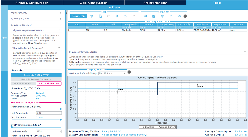

It's a complex multi-variable ​problem depending on what you're doing, the clock speeds, and a lot about what the pins are connected too and driving.
S​ome of the CubeMX tools can estimate what specific peripheral combinations contribute.

right, see in "Tools" in Cube...F303 -> at 48M + 72MHz
‎2023-02-24 3:05 AM
I can see 40.71mA consumed at 72MHz.
Can I consider 40.71mA as the maximum current consumed by the IC?

those are estimates as @Community member​ said,
Depends of which peripherals youre using, i always design for 150mA minimum. for my stm32F072 and stm32F105

If i consider IDD, then its 15.3mA( 8MHZ, Flash exe & All peripherals enabled)
If i consider IVDD, then its 160mA.
Which one to consider IVDD or IDD value?

you just said your clock was 72Mhz, so the estimates are 77,4mA
