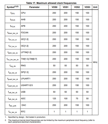

Hello @Omgareyouokaydood
ADC and DAC are sharing same clock source. In case both are used, the clock can't be higher than the Maximum allowed clock frequency for the ADC as shown on the Table 17:
But, if we use only the DAC, User must still be able to select a clock higher than the ADC limit clock. This is a known issue on the CubeMX that has been already reported on the internal ticket 179875 for correction on the coming version of the STM32CubeMX (coming soon).
Best Regards.

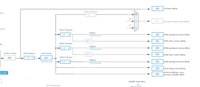

2) When performing a heavy FPU operation, such as calculating a sine wave, which clock is used? Is it always 250 MHz or is it from one of these (picture below) ?
This is my main concern here. I need a very high FPU clock to create arbitrary wave forms using DAC.
And I already noticed that the computations to make such wave forms are heavy.
Therefore if the FPU unit depends on the HCLK, and I have to lower it to make DAC and ADC work, I am screwed 🙂
1) As you can see on the Datasheet, on our side, we can ensure that the ADC will work fine only if his frequency is under the maximum frequency mentioned on the datasheet.
2) The FPU is clocked from the same source the Cortex-M33 which use the FCLK that works on a frequency up to 250 MHz.
3) As you can see on the first note under the table 17 of the datasheet, the frequency values are specified by design and not tested in production. So, it may work on a frequency more than specified but we can't guarantee this.
Best Regards.
