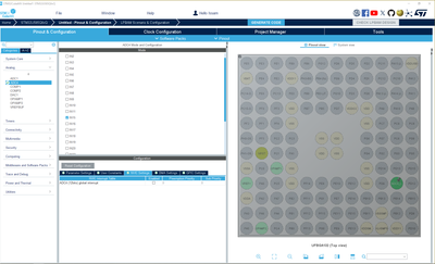

I'm encountering an issue with STM32CubeMX while configuring the STM32U585QII6Q microcontroller. Specifically, when attempting to configure PD11 to ADC4_IN15, I find that the ADC4 channels are grayed out or inactive.
While using STM32CubeMX, I can assign PD11 as ADC4_IN15 in the pinout view, but it remains orange (not configured). However, in the "ADC4 Mode and Configuration" pane, I am unable to configure it.
For the STM32U585QII6 variant, I can configure ADC4_IN15 without any issues. However, in the case of STM32U585QII6Q, I encounter this problem.
I have reviewed the datasheet, but I couldn't find any reference to different ADC settings between these variants.
Could it be that the Q variant does not support ADC4 channel 15, or is this possibly an issue with STM32CubeMX?
Thank you.
Ari

Hello @ari_v2
It works fine on my side I can configure PD11 as ADC4_IN15 on both "ADC4 Mode and Configuration" and "pinout view".
I think you should update to the last Version (STM32CubeMX V6.11.0).

Yes, I updated and all is OK.
Thank you!
