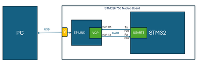

Best answer by mƎALLEm
I configured the USB settings in CubeMX for CDC communication and tried to transmit data through USART3
Why are you needing to activate USB CDC?
You can use USART3 (as described earlier by @Tesla DeLorean: regular UART config) and use VCP of ST-LINK of the board.
This is a sketch illustrating the connections between the different parts:

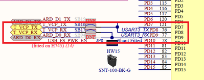

There aren't any known issues with the NUCLEO-H755ZIQ serial port, by default the VCP furnished by the ST-LINK resides on the H755's USART3 using PD8 / PD9. The others should also work for external connectivity, provided they aren't conflicted with other usage on the board.
Here's a schematic if you've not found that yet
https://www.st.com/resource/en/schematic_pack/mb1363-h755ziq-d01_schematic.pdf

The first issue resides in the UART instance selection. You selected USART2 while you need to select USART3 (Tx: PD8 / Rx: PD9) as this is the instance connected to the VCP. That's why before starting to struggle with the coding and configuration you need to check the HW and schematics before!
Same issue as this thread.

USART3 is used like a regular USART, you send data to it using HAL_UART_Transmit() functions, and recover via the ST-LINK's COM port on the PC side.
You don't have to configure the H755 as a USB CDC Device.
Make a simple app to enable USART3 PD8/PD9 at 115200 baud, write a simple function to send a string to USART3, confirm you can see the data in a PC Terminal application.
For a H755 hosted CDC you'd use the USB connection on the South end of the NUCLEO-H755ZI-Q
