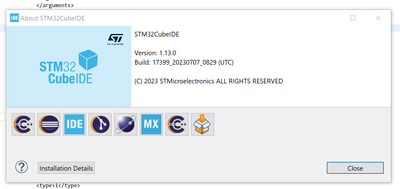

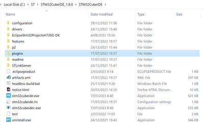

I have a similar warning: "Unknown referenced nature: fr.ac6.mcu.ide.core.MCUProjectNature"
I am unable to apply the fix as per @Julien D.
STM32CUbeIDE root has no jre/ subdirectory in my case (Windows10 64bit professional)
Current version (directory name 1.8.0 is remanent of first install)
