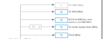

It's in the manual that SDIO adapter clock (SDIOCLK = HCLK).

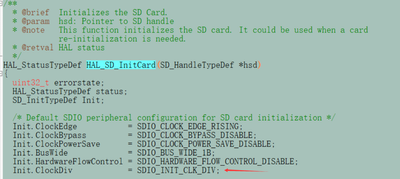

When HCLK is set to 72MHz, SDIO_CK is configured through the register SDIO_CLKCR bit 7:0(CLKDIV). When the bypass clock is not used, SDIO_CK=SDIOCLK/[CLKDIV+2], which should be the frequency division of 72MHz
But the default parameter in the code generated by STM32CubeMX is to divide 48MHz.
The two macros in the file stm32f1xx_ll_sdmmc.h are defined for 48MHz, and these two macros are used when calling the HAL SD Init function.
If used in this way, it will cause overclocking.

I think the problem here is that this macro definition is used in the HAL_SD_InitCard function called by HAL_SD_Init.
The main purpose of HAL_SD_InitCard is to generate a series of commands for SD card initialization. This value cannot be changed by the user through the parameter, which will cause the clock to exceed the specified 400KHz.
Using the generated code directly will result in an inappropriate clock rate at initialization time.
