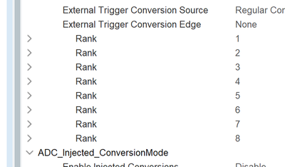

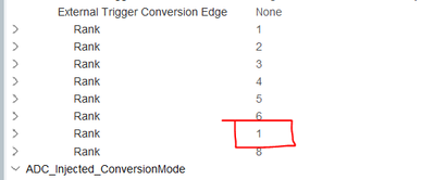

With new and fast N6 MCU comes new CubeMX package which is full of bugs and errors, I spending hours to find and solve such problems, now I cant trust cubeMX at all, every function must be checked after code generation !
ADC rank must be 7, but cubeIDE generate 1:
