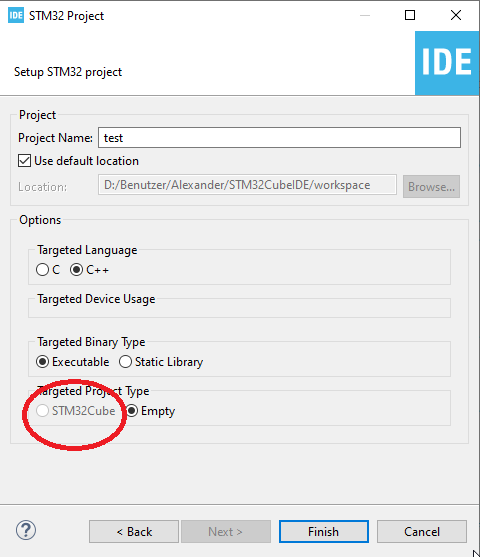

I am currently working with STM32 Cube IDE
Version: 1.18.1
Build: 24813_20250409_2138 (UTC)
When I try to create a new project I select the processor and click next. Then the setup dialog appears (as usual).
But in the targeted device selection the STM32Cube IDE project is not selectable:
Consequently I get no .ioc file after creating the project.
Things I already tried:
1. Restart IDE
2. Update
  • Help > Manage Embedded Software Packages
  • Under STM32Cube MCU Packages, install the firmware for your MCU series (e.g., STM32F4).
3. restart IDE with -clean option
In a bash I used
STM32CubeIDE -clean
Nothing helped. What can I do?
regards
Alexander

Hello @DocAlex
I recommend you to use the latest version of STM32CubeIDE 1.19.0 ,it works correctly .
if you want to keep using 1.18.1 ,please try to:
-Close STM32CubeIDE
-Delete all those files from your PC: .stm32cufinder, .stm32cubemx, .stm32cubeide and .stm32cube
then restart the STM32CubeIDE and retest again.
THX
Ghofrane

DocAlex
Wow, what a response time!
Tried.
I installed the update.
It fixed the problem. Thank you!
