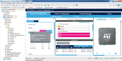

Hello i have a Nucleo H745ZI_Q board in this Ethernet without RTOS is working fine but  when am going to configure ADC  all the three ADCs are shows error message --> Partly Disabled conflict with: ETH: mode RMII   even many channels also showing error message . Whats the issue ?? How to resolve this ????

Sure, you can use everything, thats not marked as used (red).
But you cannot use pins for different functions at the same time - obviously.
This is only WARNING you, that some pins are no more available; this is no ERROR !
In your pic you see:
IN 4 , 7 , 8 no more available , = red .
IN 2 , 3 , 5 , 9 , ...   still available , you can use this inputs & ethernet .

>Whats the issue ??
What it tells you : some pins are not free any more, you put some function on them.
Set ETH to unused/disabled. Then pins are free again.
You will see this yellow or red marked things more and more, when you use more peripherals.
