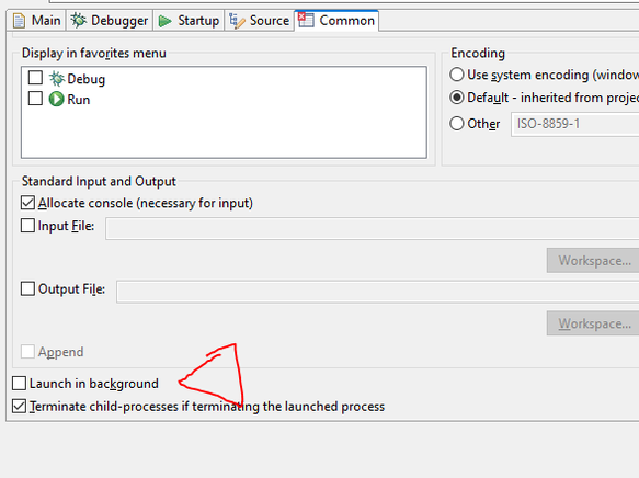

Only now I noticed that 'Run' button indeed flips from incactive to active during flashing process/debug session launch, but I am not able to click it as there is a modal window showing progress of the flashing progress
I'm using STM32CubeIDE 1.15.1 at the moment, I haven't seen the window. I also have external flash which flashes after the internal flash is flashed and that can take a while. Most of the time I can control myself to not press the button, but it's so tempting to click a green play button that I sometimes forget.

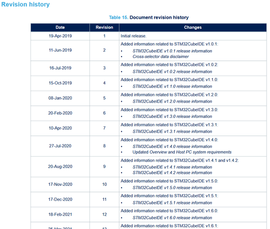

There is a kind of information about release dates but would rather see it stated within each version update note. not as a sideproduct of the document's revision history.
So this thread  started on Jun 2020, when CubeIDE latest version was 1.3.1.
https://www.st.com/resource/en/release_note/rn0114-stm32cubeide-release-v1161-stmicroelectronics.pdf
>> "I haven't seen the window"
You will with this option off:
[Debug Configurations > Common]
