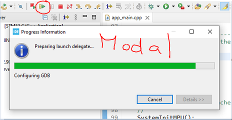

Ah, I think I got it - so IDE shows active 'run' button even though the flashing is still in the progreess, in the background. That's not good.

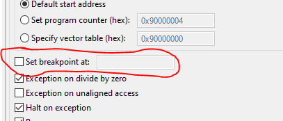

When I disable 'Set breakpoint at' my program does not stop after flashing, I think that is what you are after
[Debug Configurations > Startup ]
Only now I noticed that 'Run' button indeed flips from incactive to active during flashing process/debug session launch, but I am not able to click it as there is a modal window showing progress of the flashing progress
Maby I enabled that modal progress window somewhere.
