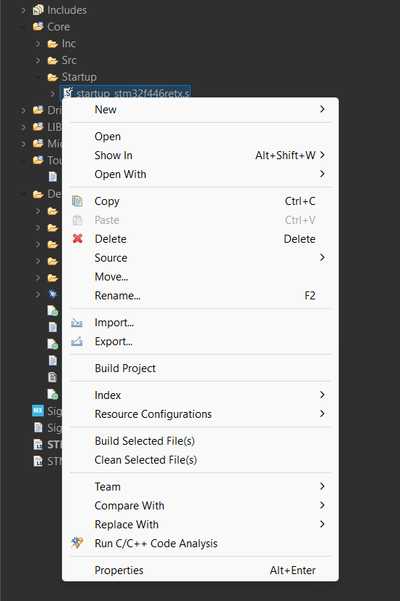

Not sure if it's been mentioned previously (this is a very long thread), but I've had luck with disabling debug symbols for specific sources I don't want randomly opening.
1. Right click on unwanted file(s) in the Project Explorer. Choose the Properties item at the bottom.

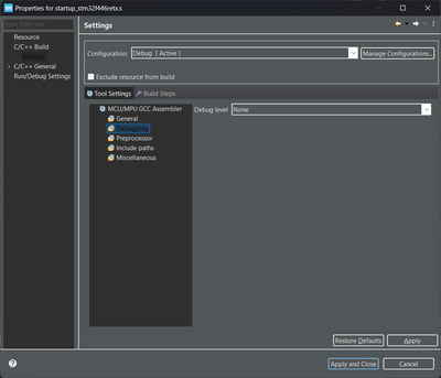

2. Go to C/C++ Build >> Settings. Change Debug level to None.

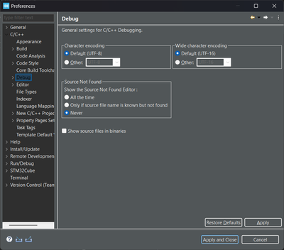

3. If you get warnings about missing sources or symbols, you can disable those too as suggested by configuring the behavior for missing sources (Window >> Preferences >> C/C++ >> Debug >> Source Not Found).
It's a bandage fix that doesn't solve the root problem, but it's good enough for me at least.

1. Uncheck the “Enable live expressions” checkbox in the debugger settings in the debug window (Run >> Debugger Configuration >> Debugger >> Misc). This checkbox was causing random windows to open. If you uncheck it, only one file will open, which we will disable below.
2. Disable debug information for Startup/startup_*.s as shown above.
3. Disable warnings about missing sources or symbols as shown above.
