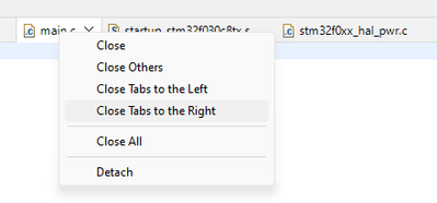

@Lukasz Nowak wrote:
This often leaves dozens of open files, completely ruining IDE navigation.
I think the extra tabs always open to the right of whatever you already had open?
So, as a workaround, right-click on the right-most of your "own" tabs, and choose 'Close tabs to the right'
The problem is that if you don't have main.c opened and have a breakpoint set there you have (from left to right): files you had opened, new garbage file, main.c. So the garbage file is now in the middle. Repeat debugging a few times and it is total chaos and all tabs are occupied.
I followed a tip to prevent the flashing from crashing by accidentally clicking on the play button during flashing: https://community.st.com/t5/stm32cubeide-mcus/jumping-to-random-file-after-pressing-run-button/m-p/740123/highlight/true#M32142
It should be easy for ST to prevent opening new files while this dialog box is visible. That should fix it imho.
