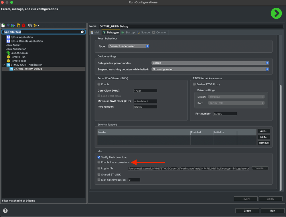

Hello. When I press to Run (Run main.c) button, STM32CubeIDE opens random file, possibly, from current repository, for example: startup_stm32l452xx.s, core_cm4.h etc...
Code is loading successful, but this side effect bothers me.
I would like to disable this function. How can I do it?

overlaine
Same problem on OSX:
Version: 1.18.0
Build: 24413_20250227_1633 (UTC)
I can resolve this issue by disabling Live Expression in the Debugger settings (Misc).
