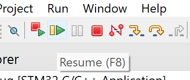

‎2025-05-30 6:12 AM
@TDK wrote:Hit pause if you need it to stop.
@TechyAry that's this button:
What that does is to halt the execution of your code wherever it's currently at, and allows you to use the debugger to inspect variables, etc.
To set the code running again, you use the 'Resume' button (or F8).
There are many reports on here of unreliability with "live expressions" - this approach is reliable.
